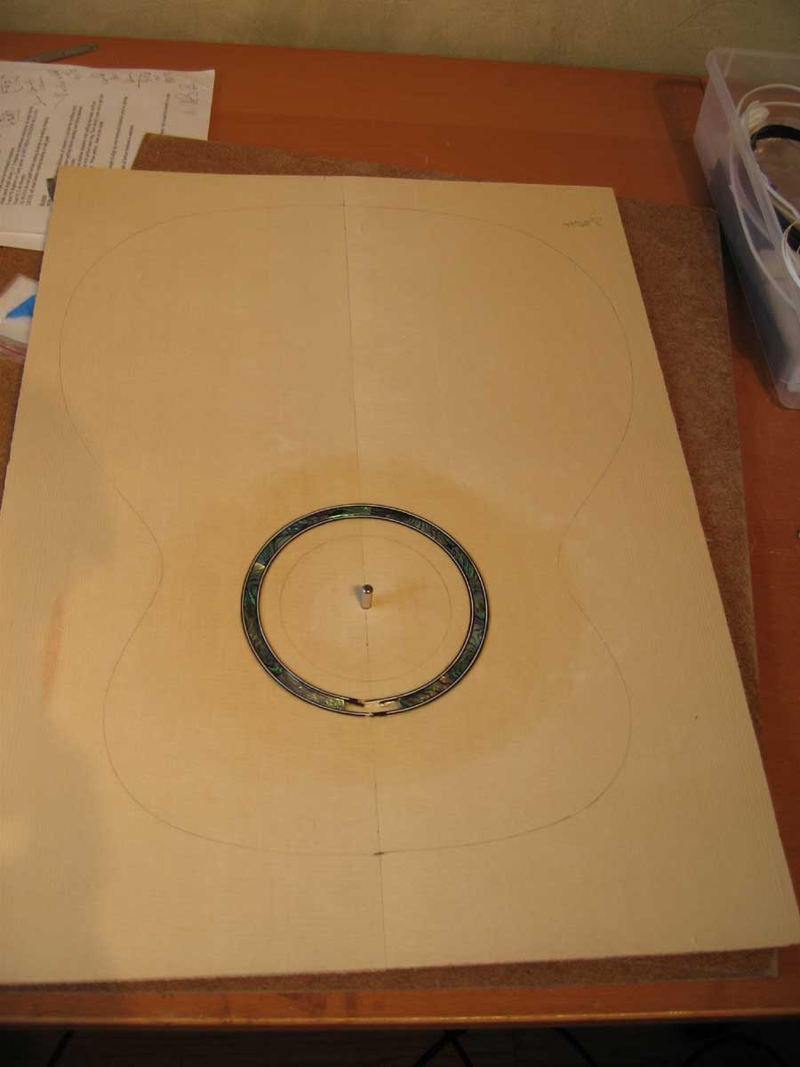

I buy abalone rosettes from Andy DePaule. Most are 4.92" internal diameter.
He as several widths. Just route as you would any other rosette. Miter the
ends of each piece so they fit together. I typically
set everything in dry and then flood with superglue. Then run through my
thickness sander to clean up. (IMPORTANT - I coat my rosette channel and
at least 2-3 inches on either side with a vinyl sealer to prevent staining the
top with superglue....lacquer would also work)

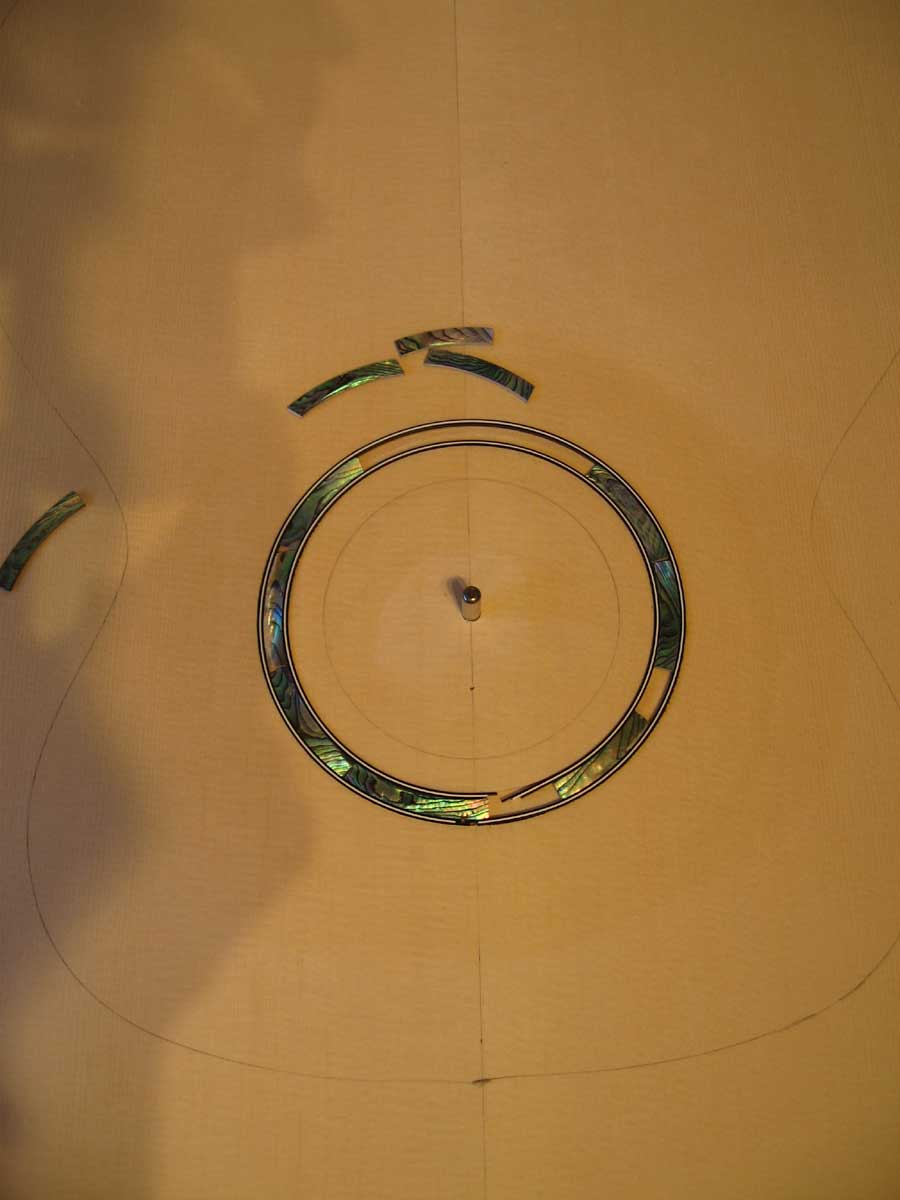

Here are some other picts I found. When I route my channel, I use a
dremmel with the stewmac attachment. I first route out the width of the
abalone. Then I route out wider for the purfling until a tight fit. I work
slowly and work my way wider both inside and outside to get a tight fit.
My purfling strips are not bound together. I just work in all 3 on the
outside
and inside. I go back and forth a lot. You can see how each piece comes.
Just miter to fit together. BTW I don't use ablam. I use real shell. It allows
me to have a bit more play with the thickness. With ablam you must
route flush, so when you sand you don't delaminate

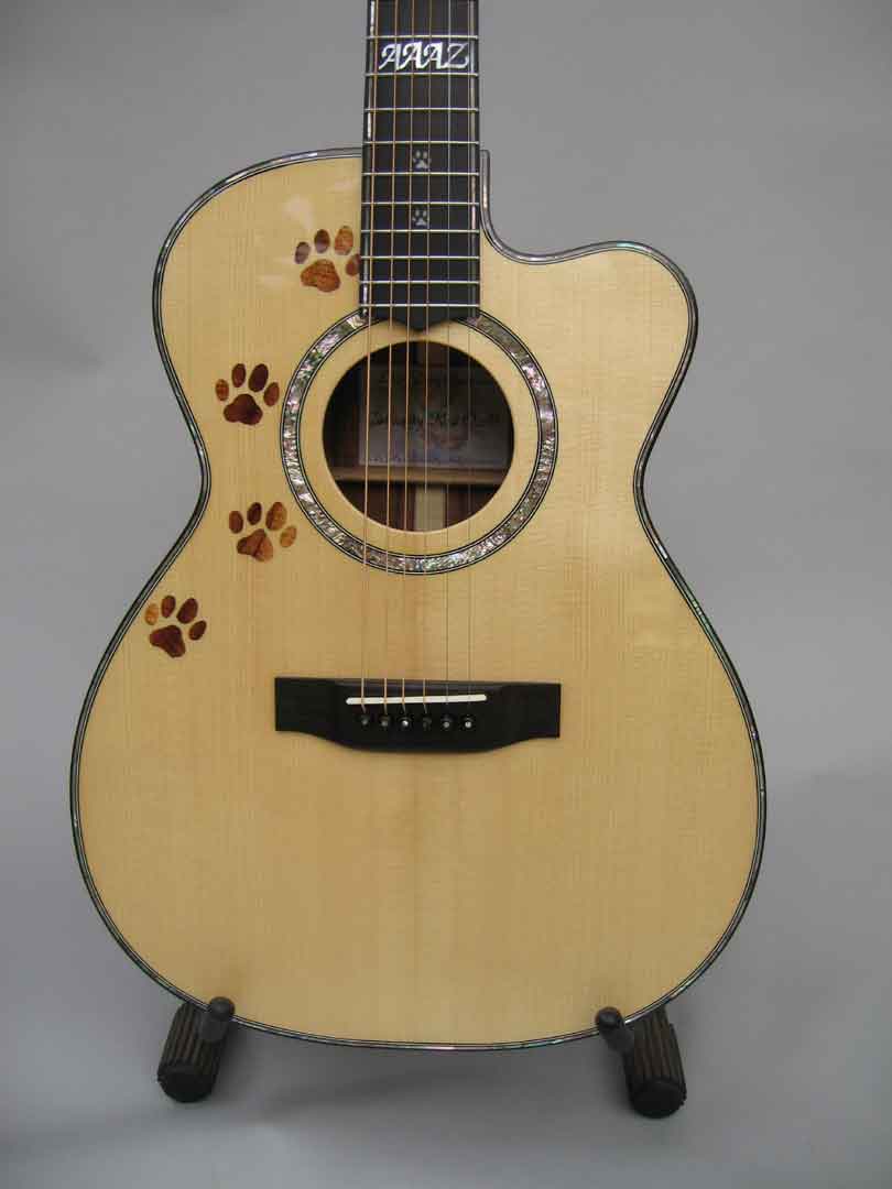

PostPosted: Sat Sep 30, 2006 4:28 am
Andy, did you inlay the paw prints into the top?

Thanks guys...what do you use to miter/cut the abalone, and when you say miter cut are you just referrring to a straight chop-cut on the abalone so they just butt up against one another squarely.
Can you use shellac to coat the channel and top to prevent staining? Will the superglue stick to it in the channel?
Greg

I miter with a bit of an angle.   Not just a 90 degree butt. To do it I use my
upright belt sander.
Lillian
As far as the dog prints, they are inlayed pieces of Koa left over from the
sides.
